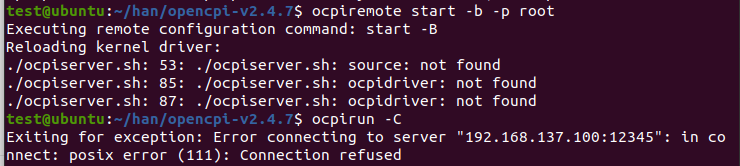

./ocpiserver.sh: 53: ./ocpiserver.sh: source: not found
./ocpiserver.sh: 85: ./ocpiserver.sh: ocpidriver: not found
./ocpiserver.sh: 87: ./ocpiserver.sh: ocpidriver: not found

I tried adding #!/bin/bash at the beginning of the sh script. It seems to solve the problem of source: not found, but when I re-execute ocpiremote start -b -p root, I get the following error
test@ubuntu:~/han/opencpi-v2.4.7$ ocpiremote start -b -p root
Executing remote configuration command: start -B
Reloading kernel driver:
The driver module is not loaded. No action was taken.
No reserved DMA memory found on the linux boot command line.
insmod: ERROR: could not insert module /root/sandbox/xilinx19_2_aarch64/lib/opencpi-4.19.0-xilinx-v2019.2-v2019.2.01.ko: Invalid module format
Driver loading failed.
